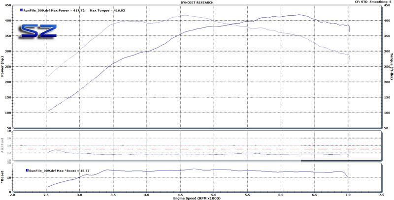

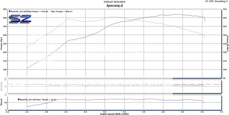

Message Sometime in the future I will be doing a plenum pull and finally changing out the old style injectors for the new style ones. While the plenum is off I'm considering adding larger TB's but I'm not sure if it's worth it especially since Z1's are really the only game in town and I'd rather not give them my business. I know of a 3076 turbo car with over 500whp that switched from 58mm to 62mm and the gains were negligible. Less than 5hp gain IIRC.
For reference:

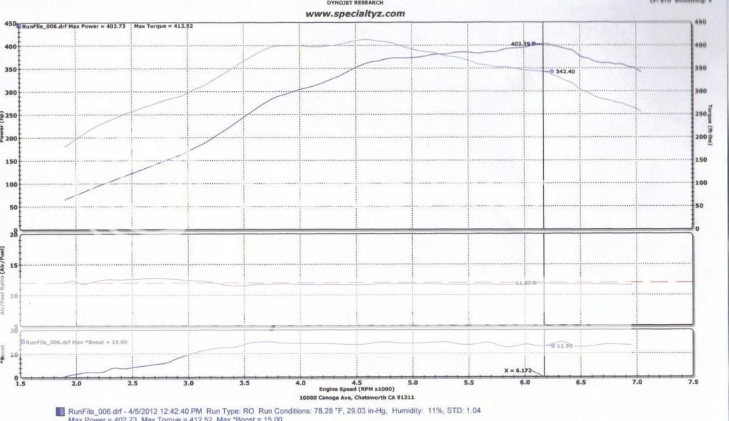

My car and mods
Stock motor/turbos/manifolds/TB's
555cc Nismo Injectors
Selin Dual POP w/ JWT POP Chargers
Ashspec Massives v3 + 2.5" Inlet/IC Piping
SZ 3"DP/TP
SZ 2.5" Catback
UD Pulley
RPS Lightweight Flywheel
MWS 1-piece Steel DS
This is Evan Wright's car with almost the same mods as me except he had exhaust manifolds and SZ accordion replacement intake pipes but stock oem inlets directly off the turbo.
This is Adam's car with essentially the same mods as Evan Wright except for Tomei exhaust cams and some mild port and polishing of the upper intake plenum. I imagine Evan did something similar to his plenum when installing the Z1's TB and just didn't both to list it in his profile.
It hard to see since the pulls were started at 2k rpm on my car and 2500 rpm on theirs but it appears my car makes a smidge more tq down low and by 3k rpm we are all at 300tq. After that their cars start to pull away a bit and hold the power longer. Anyways my question is how much of their gains are from the larger TB's and how much are from the manifolds?
I know it's doubtful but has anyone done back to back testing just changing the TB's, or manifolds, or inlet piping but I'm trying to see where the gains are coming from. I'm no expert but it seems like the inlet piping is huge for gains down low and the manifolds for gains up higher in the power band. I'm not quite sure where the TB's fit in. It's also be curious to see if Rob'z bored out stock TB's make any difference. Perhaps there is a point of diminishing returns on TB size. Thoughts?
